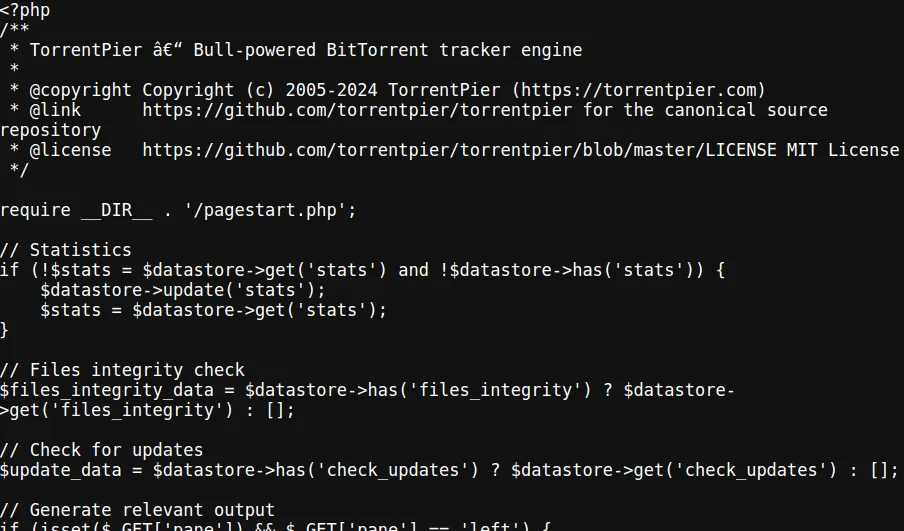

THE SITE RAN BUT EVERY THING IS NOW CODE CODE. NO INDEX HTML OR CSS TO LAND . WHY IS THAT?
Of did I do someting wrong again ?
Idk. Provide please more information about your problem.
I TRIED SEVERAL TIME . EVERY TIME I TRIEM SOME PROBLESM ALWAYS CAME UP .
last night was php.ini file problem . Then came the ext destination problem .
