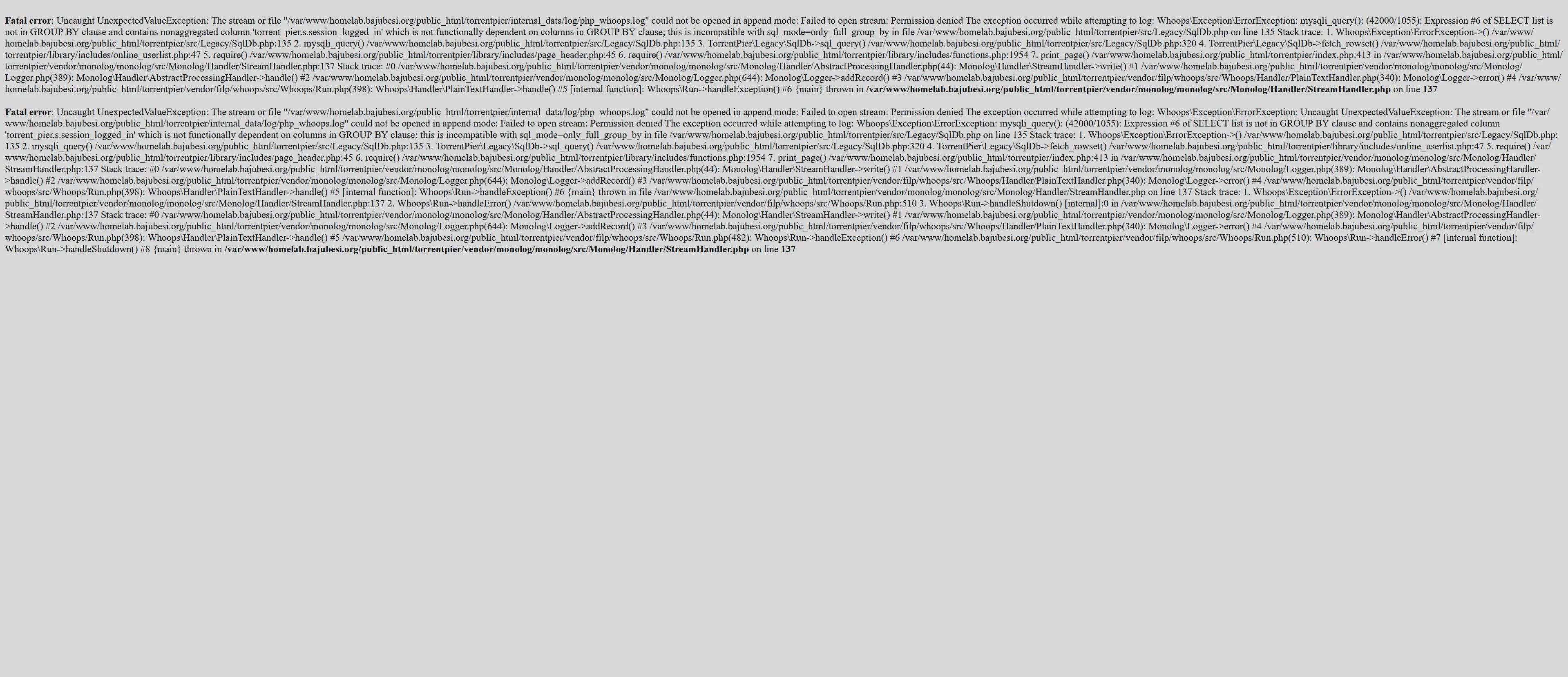

hye i have a webserver setup, with domain, my problem is when i try to install torrentpier in var/www/mydomain.com/public_html/torrentpier it give me error after i successfuly install it with Composer, if i install it at other place i don't know how can i view torrentpier, im using webserver to easily view it.
my question is how can i correctly install torrentpier in webserver? is there an option to install like that ?? please help

yes i follow all the instruction there, and already change the $reserved_name and $reserved_port to mydomain.com/torrentpier port : 443 , is this correct setting? the default permission is 0755 for all the folders, what am i doing wrong?
can't work with mysql 8? i have other website that running latest mysql and php 8.2 , this is the spec :

Use PHP 8.1; compatibility with the PHP 8.2 is still ongoing development.
Install MariaDB (compatible with MySQL queries but faster and open-source).
If the issue will persist, would be glad to hear it.
